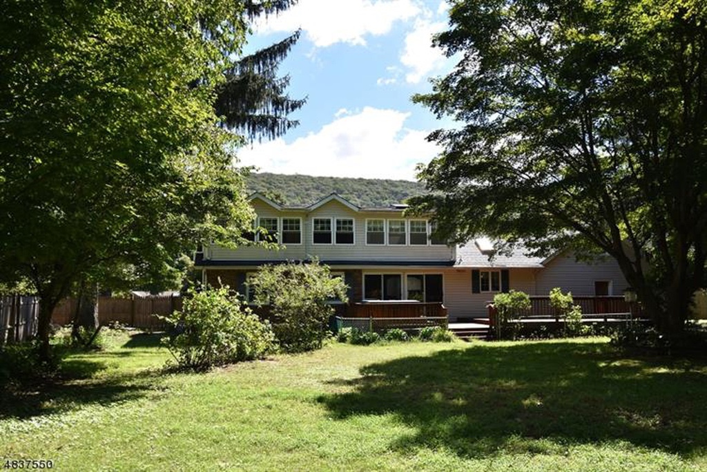

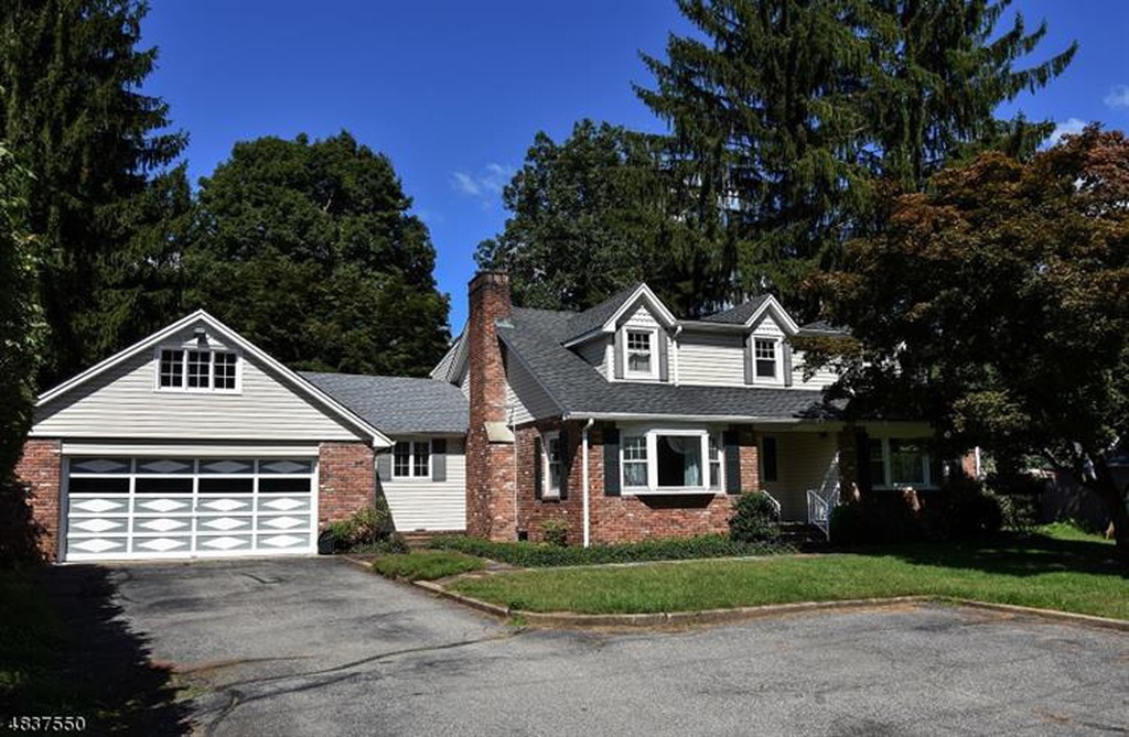

Hi. We are new to wood burning. We purchased our house in northern NJ in March. It is an approximately 2600-2700 sf cape cod style home plus an un heated basement. The house was build in mid 1950s and mostly brick faced on lower level and vinyl on top which has dormers in front and back. The home has an existing wood burning fireplace which is fairly central to the first floor and we are having a Regency i3100 wood burning insert installed in around 2 weeks which is supposed to heat up to 3000 sf. The house has a single zone oil fired boiler with cast iron baseboards and in the wall cast iron radiators in most rooms aside from two that are dormered out on second floor in back is the house. They have newer hot water baseboards. Their is also a hot water heater heated by the boiler. Our kitchen on the first floor was originally at some point a breezeway to the garage and was converted to living space. It has a vaulted ceiling and no heat (it is open to the rest of the house and just gets heat from there). It is definitely colder in there. When cold we have used an edenpure space heater to help. The rest of the first floor ceilings are 8 foot and the second floor they are 7 foot. We are most likely going to burn 24x7 except when away which we will do a couple times to visit my daughter at college.
So my questions are as follows.
How much wood would you expect I will need? I had 4 cords delivered and the wood dealer said they have been seasoning since January. Some is heavier than others and he said the heavier stuff is Oak. There is also supposed to be ash and maple.
To protect my pipes do I need to use the boiler every so often and if so how much?
Any other tips you can share are welcome.
