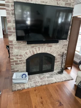

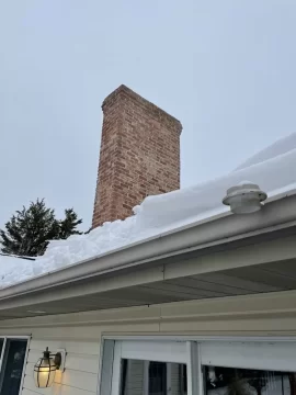

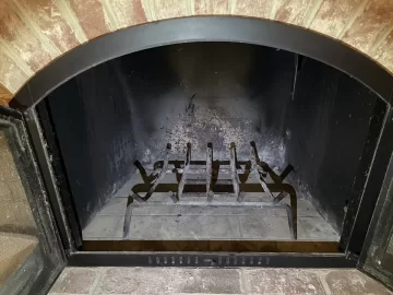

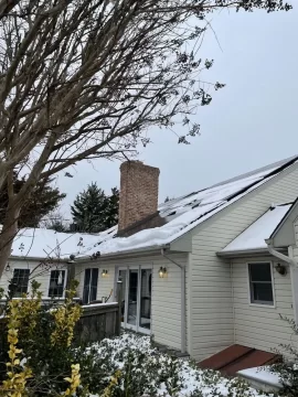

The fireplace in central to the house, and has cathedral ceilings around. The fireplace and flues are all masonry (behind the firebox). Total chimney height is 25’ +/-. The fireplace has an arched face, 37” wide, 28” high at center & 22” at sides. Center is 22.5” deep at bottom, and 17” at top. 28” wide at rear bottom. Everything starts to taper around 15” off floor. Picture is attached of face, and I have every intention of meeting clearance requirements (tv may need to relocate)
I have been looking at the TN20, Osburn 3500 & 2000, Drolet 1800/CW2900. the 3500 is just barely too big to fit . I really like the option to load N/S after having the NC-30 for years. My only hang up is the 2000 is 2.4 CF vs the TN20 at 2.0. The TN20 can load N/S 18”. I’d ideally like to put the largest insert I can in there, so it’s likely between those two unless you guys have any suggestions. Is one a better stove than the other? Quality-wise?

![4A1323C8-3893-4E94-91F2-AD64833CA371.jpeg 4A1323C8-3893-4E94-91F2-AD64833CA371.jpeg](https://www.hearth.com/talk/data/attachments/275/275628-85262ef351f51604502dd0aa86560479.jpg)
