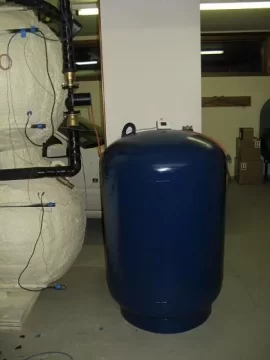

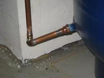

I finished up my 100G propane expansion tank install with 1000G of storage. It sits on floor 1/2" copper runs down to bottom of tank and it works great. In charging mine I put in about 30 gallons of water before I started to heat storage. I ended up taking out at least 30 gallons once I was up to temp 160 /170F because the expansion tank had filled to 70% and I was already over 20 psi and storage temp hadn't maxed out yet. Once I got it balanced it's worked great. For both days !
Rob
  • New idea for expansion tank
I did get my tank in last fall. I used an 80 gallon tank as an expansion tank. I had plumb it to a hole about 10 inches up on the side but I ran out of expansion space as has been mentioned. This fall I replumbed it to the bottom and put drains in bottom and in the hole 10 inches up that way I have some idea of the amount of water in it. When the water hit the 10 inch level, I put in air to make up 5 psi cold. runs about 10 psi when hot. hope this continues to work OK.
