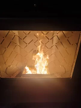

Just had it installed Monday, has a fresh air line to outside, and the exhaust exits out to a T and up about 5 feet. Used it yesterday for about 8 hours and cleaned it to get used to it. Today the stove ran for 5 hours, turned off for 3 hours, then turned on for another 5. In that time I noticed the flame would be going perfect, then every couple minutes die down a bit to just in the burn pot. The augur would keep filling it slowly and once enough pellets were in it, I'd have a great flame again. Thinking the feed rate needs to be increased correct? 2nd issue I'm seeing though is unburnt pellets jumping back out of the pot, and below to the ash pan. Will increasing the feed also stop this? 3rd issue is the ignitor pipe is higher than the exhaust pipe which cants the burn pot a bit. Is this normal or am I just OCD? Lastly after 10 hours of burning I feel there's A LOT of ash. I took the follow photos once I opened her up to see these issues. I vacuumed it all out and emptied the ash to get it ready again for tomorrow. Thanks in advance for any help. Been lurking here for weeks and finally made an account today!
