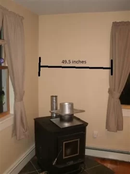

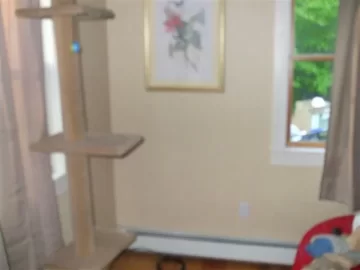

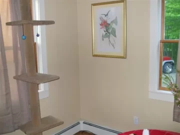

Now in my new home there is really only one place to set up my pellet stove because of the setup of the building...I attached a couple photos to show my install location...but have a few questions...Now obviously the cat tree and curtains would be moved/changed...
1. Will the baseboard heaters be an issue?
2. Will I have enough clearence to my windows do you guys think? The wall with the picture on it is 46 inches from the corner to the outer edge of the window trim and 49.5 inches to the inside of the trim, the other wall is 26.5 inches from corner to edge of window sill and 30 inches from corner to the inside edge of the window...I will be using an OAK...which I believe makes it so that the exhaust has to be 18 inches from a functioning window...correct? with the measurements I would think that I will have more than enough clearence on either side of the exhaustto meet the requirements...
The distances on the inside should also not be an issue as I will have plenty of space to meet the required distances...
