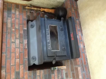

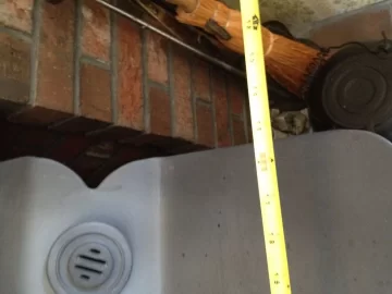

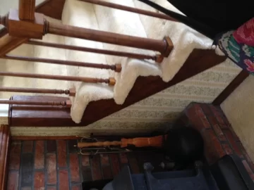

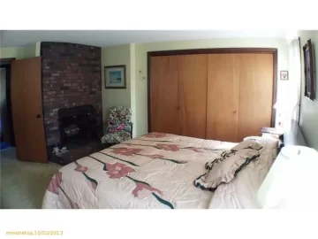

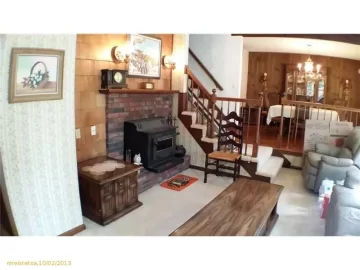

The home is a saltbox with large central chimney. Fire place in living room and master bedroom above. As you can see from pictures the current owner has carpet right up to the lip of each Fire place. That will be fixed to proper clearances. My Big problem is the wood stove insert in the living room. and the positioning of the whole thing. The Stove is called an All Nighter and looks like it has been there since the late 70's. I don't think they have burned more than 2 fires in it since install. It is in perfect condition. I would love to keep it but probably not reasonable due to clearances. It is only about 14 inches from stair case I 'm not sure if I can have a wood stove there at all or if I can put some kind of heat shield up. Any Ideas???
