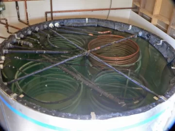

Piston, for what it's worth, here is a picture of my non-pressurized 850 gallon heat storage tank, taken when I had the top off after adding one more heat exchange coil (the one with the new-copper shine) to replace the radiator on my Kubota generator--as per the second picture. (We live off-grid, with solar, wind and, when unavoidable, diesel to keep the batteries charged.)
The water in the tank is nothing more than mass to hold heat. It could have been sand, in theory at least. The water in the picture was the very same as had been initially been put in the tank some 4-5 years previous.
I have two boilers--one oil and one a wood gasification boiler. They provide heat to the heat storage tank via heat exchange coils as seen in the picture. When the house requires heat for the in-floor radiant system, the heat is drawn from the heat storage unit. Same goes with DHW. When we turn on a hot water tap, the hot water comes via the DHW exchange coil in the heat storage tank.
When the boilers are running (whether wood or oil), they are adding heat to the heat storage tank. This is critical for the wood boiler, as it allows me to burn the boiler 'full-out' for the most efficient burn possible, in effect simply transferring the BTU's in the firewood to the heat storage tank.
I also have a solar thermal array which helps heat the storage tank in the summer, when the only heat demand is DHW. I don't like burning wood (or oil, for that matter) in the summer.

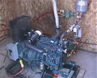

Also cannot resist commenting on the noisy generator comment. I built a well-insulated gen shed with a hospital quality muffler. Unless you are standing next to the gen shed, it is impossible to hear it running.

Thanks for the pics, it's neat to see what the inside of a storage tank can look like. I think that is an incredibly good idea to use the heat sink as a radiator for your generator! Great use of otherwise wasted heat.
