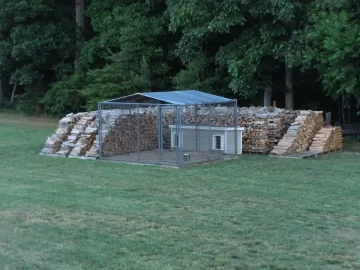

Hi All,
My wife and I are having a shed/garage built, probably 14x24. I have approximately 7 cords stacked on our property that are slated for use 11/12 and 12/13 (avg 3 to 3.5 cords/year). I'm wondering if I should put a lean-to off the building for firewood storage? My property is rectangular - with my front door facing darn near due east. The front of the garage will also face due East and I'd like to put the lean to on the back side of it - due west. This will mean the wood will get no direct sun and minimal wind because our lot backs up to the woods. Am I making a mistake by not letting the wood season out in the warm Delaware summer sun? The picture I'm including is of the dog kennel that is currently in place of where the garage will sit. The entrance to the kennel is facing due east. I'm hoping this will provide some insight, because I'm worried that putting the wood under roof will hinder it seasoning through the summer despite being a big help over the winter.
Opinions please, what should I do?
Thank you!

What type of wood are you burning? You said right now you are 2 years ahead now, if you're burning softwoods like me 2 years stacked anywhere is plenty of time to dry. If you're burning oak, I'd make sure it's out in the sun/wind. Any other possible locations where a lean to might get more wind? What about building the lean to off the North or South side of the garage, almost like a carport?

Leave wood outside until its seasoned, then load the shed
I would assume that the proposed lean-to would be much closer to the home. If I were you I would put in something to store my seasoned wood in for the burning season. Season the wood in the sun by the kenel. In say Oct/Nov timeframe make sure you have 3-4 cord (enough for the season) in the lean-to. It is already seasoned and now it will stay dry and snow free untill it meets it fate in the burning appliance.

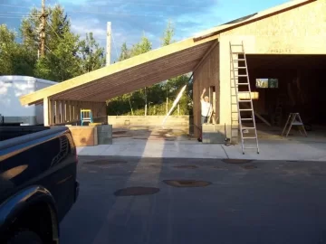

When I built my shop. I put a (20' wide) lean-to type un-heated one attached, as I built it. Became "Dave's Toybox"

I say that if the lean to is an option as far as permits, space, cost, etc. you should build it whether you use it for firewood or anything else.
