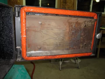

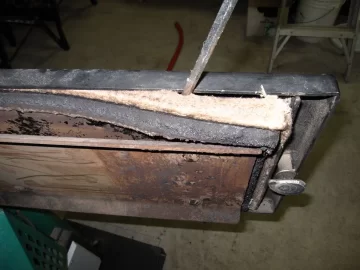

Here is the old gasket coming out:
  • [Hearth.com] New EKO Silicone Gasket

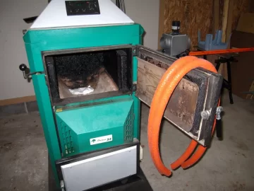

The new gasket going in:
I had to cut about 1 inch off the end.
I will have to back the door hinges back out at least one turn in order to get the seal to fit.

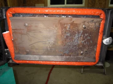

Another view of the completed gasket
Silicone sleeve over solid fiberglass rope. It is very substantial, and I had a hard time working the new gasket into the groove. I think it will seal very effectively.

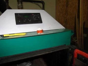

Here is the remnant of the gasket I had to trim off.
In order to get the door closed and sealed, I had to back the hinges out three full turns. I also had to put my shoulder into the door to get the handle to catch. Once it is seated and has had some heat I think it will get easier.
