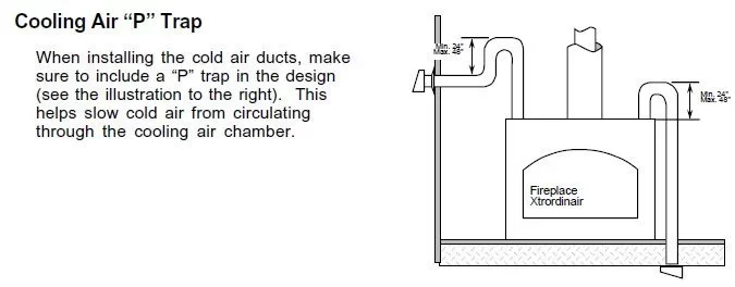

4. The FPX uses a much less expensive air cooled chimney. Some people have warned an air cooled chimney allows cold air to penetrate into the fireplace and seep into the house when the unit is not in use. But the FPX instruction set has a "P" trap setup that supposedly eliminates this problem (see instruction manual or product brochure). Hoping that's truly the case.
**** no issue with cold air seeping in
