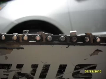

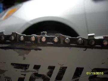

Ok, finally made it home and took a couple of pictures of the chain.
See attached.
Opinions ?

rayza said:
and the other picture
LOL its time for a new one ASAP!!!!!!!!!!!!!! you may get a couple more sharpening out of it but thats it.
Bigg_Redd said:
Sh_t
Where am I mailing my next paycheck?
HAHAHA, I have never seen anything like that either.....if it's any consolation Redd. Those Rakers are gone. Bet that chain really "bites"
