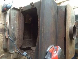

Newbie here. Just wanted to post some pics of our new hearth (start to finish). We searched high and low for pictures of this style hearth with wood storage boxes and couldn't find anything similar. The closest we came to finding something like this was in a lot of stone outdoor fireplaces. Would like to get some feedback on the wood storage boxes... I'm not sure if there is an issue here with the firewood being too close to the stove but I'm hoping some of the veterans can chime in and give some thoughts. The logs are outside of the clearance to combustibles zone and there are two layers of brick in between the stove and wood so I think we are ok. I'm only second guessing because I couldn't find any pictures online of something similar.
I must say that this is the hardest project I have ever undertaken. Only by the grace of God was it completed and turned out as good as it did. I had zero masonry experience going in but by watching a lot of you tube videos and the help of a good friend we were able to get it done. Yes, there are imperfections in the brick work but I feel as though they add character. The wood stove is an old Lopi 380/440 that was full of rust when we got it but with a little elbow grease and some new firebricks we are back in business. Yes, we did paint the brass doors to give it a more modern look. We are looking forward to upgrading next year to a larger EPA stove if the budget is willing to cooperate.
Any questions, please ask. I would like to get some feedback and I must say that this site helped me greatly and gave me the confidence to complete the install myself. I will try to post pics of the chimney pipe exiting the corrugated metal roof later. That is another story in itself!
P.S The kids love roasting marshmallows inside now and the wife is warm = win win! God is good!
