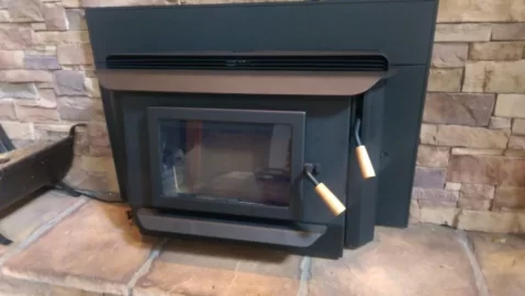

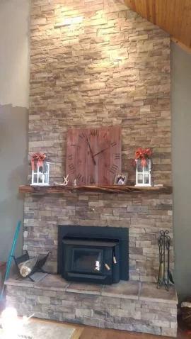

Just installed my liner and Princess Insert last Saturday. It took me and my son most of 8 hours to complete, but everything went together great and I'm ready for my first fire. I want to thank everyone on here that provides all the great information. Made everything that much easier. Went with the forever flex hybrid preinsulated liner, it went down really easy in my 13x13 terra cotta chimney. Only hung up at one spot and a little nudge with a broom handled fixed that right away. The block off plate took a little time, but it looks great. Sorry I don't have pictures of the install, I was too busy but here's the end result.

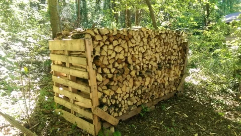

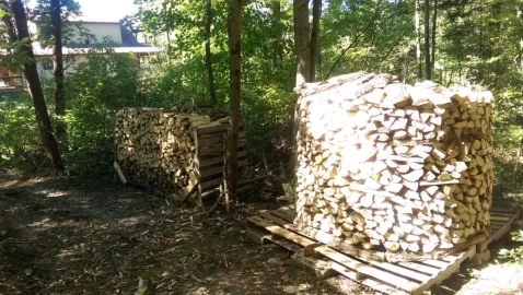

I have also been busy cutting firewood since June. Have about 6-1/2 cords so far. I'm hoping most of it is dry enough for this winter. It's all dead Ash. Here's some of my stacks:

![New Blaze King Princess Insert Installed New Blaze King Princess Insert Installed](https://www.hearth.com/talk/data/attachments/185/185011-736fca87e19a7f56164e07369b8d2ca5.jpg)
![New Blaze King Princess Insert Installed New Blaze King Princess Insert Installed](https://www.hearth.com/talk/data/attachments/185/185012-9ab977149779d40be759bcc5651c11a0.jpg)
![New Blaze King Princess Insert Installed New Blaze King Princess Insert Installed](https://www.hearth.com/talk/data/attachments/185/185013-c84726caafc034ce7961d3e807f238c1.jpg)
![New Blaze King Princess Insert Installed New Blaze King Princess Insert Installed](https://www.hearth.com/talk/data/attachments/185/185014-c75447ba9bf93e8a09573e5ad06095c1.jpg)
