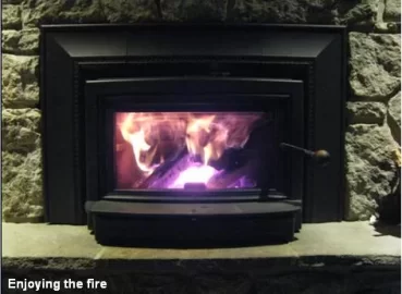

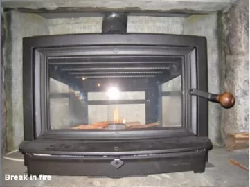

I would like to share with you that I am happy owner of a Hearthstone Clydesdale.
Our Clydesdale was started on Halloween and performs very well.
I am learning my stove's "personality" and wondering if Clydesdale is she or he.
The Clydesdale is a workhorse for sure.
This workhorse is sitting in the fireplace that is on the outside wall of 325 sq feet family room and will kindly heat 2000 sq feet house.
I am attaching a few pictures to this post.

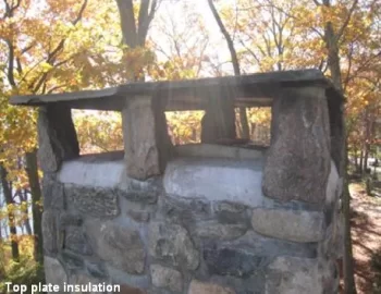

The first one is the final result of our "wood insert" project with a face of horse in the fire.

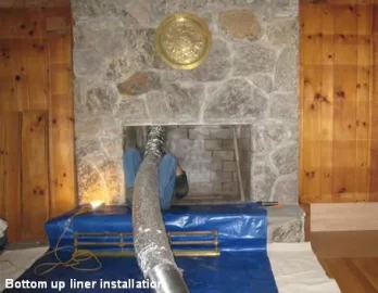

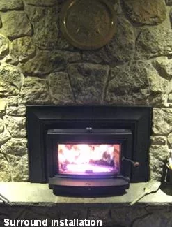

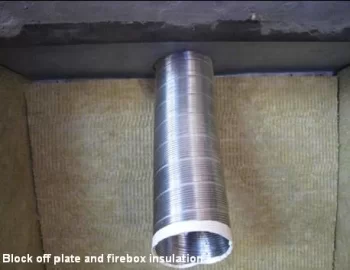

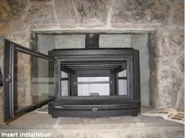

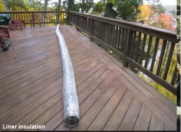

The rest are pictures from DIY installation (key milestones of the project).
We could not do it without very valuable input from threads and HearthWiki articles.
Instructions on cleaning chimney, making the block off plate, tips on firewood and starting fire are very helpful and handy.
