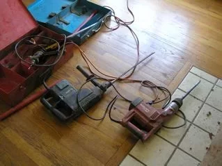

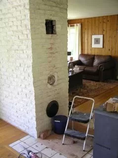

I punched a hole through my chimney to install a free standing stove it was easier than I thought. I used a Bosch hammer drill with a 24 inch long 3/4 dia bit and a chisel. I had to go in through the brick, through more brick, through some mortar and then I finally reached the old terra cotta flue. I busted through that (quite easily) and then installed a stainless steel flex liner ($500 6x25 with cap) that I pulled down the flue and out through my hole. I then mortared around the liner to seal up the hole. The liner was need required for me because my old flue was rough, so your buddy could do what I did but just install a clay thimble ( a few bucks) only if his existing flue is inspected and cleaned of course.
