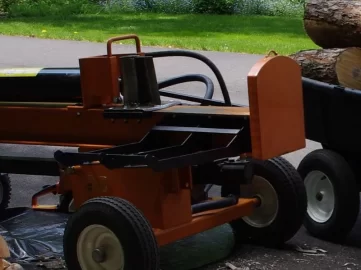

Yes it splits horizontal and vertical. The cradle is easily removed for the vertical position. It has worked well for me and saved my back from a lot of lifting.
I made my own, way less cost than what was on the market, and it stays on when tilting up (although I like horizontal better with this "shelf" cradle).

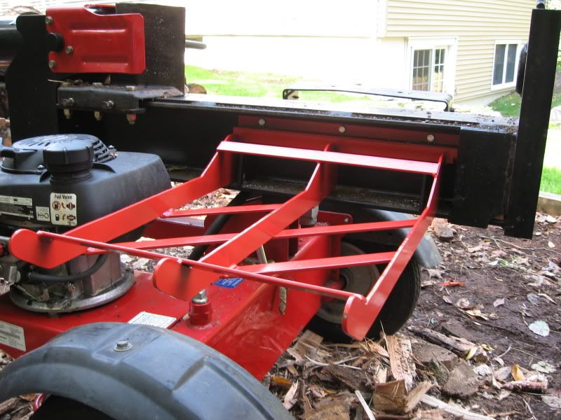

I just installed the one that Justin M has (after it was laying around all winter). Seems pretty rugged and comes off in seconds. I got it in black.
Still might split mostly vertical, but might not be bad to change it up a little.
I like one on the non operator side.

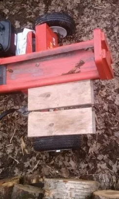

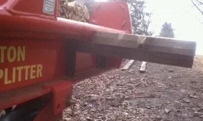

Here is what i did on mine.
I used a friends splitter without a cradle and used a big round cut the same height as the I beam as a far side "table"

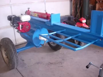

I've finally gotten around to splitting.
The eBay cradle has been working great!
VF- what splitter is that cradle on?

mwn: It is a 30 ton Harbor Freight

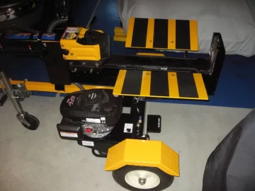

I have a pretty nice cradling beam on my Huskee 35T but, for when I going horizontal, I use a heavy duty half pallet on two saw horses nudged up against the non-operator side of the beam. I can stage several rounds on the table as well as use it to hold part of the round I'm currently working on. Works for me and, as a salute to a real scrounger, didn't cost me a penny.
