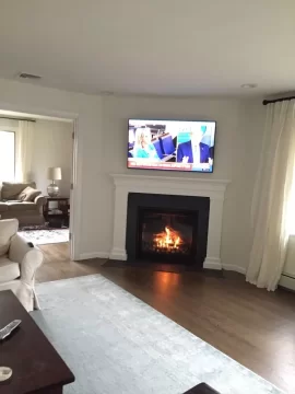

We installed a propane fueled gas fireplace this year and love it. But it is an investment and you want to get it right in terms of safety and aesthetics. A properly installed and well designed fireplace will yield something like a 90% return on your cost if you sell your home. If you have the skills and tools to frame, sheetrock, finish your fireplace that's a money saver, but you need to be comfortable with doing the work and you definitely need to understand the clearances required for combustible materials, etc.
Rather than use a fireplace dealer we opted to use contractor with experience in installing gas fireplaces.
We visited several fireplace dealer showrooms and did a lot internet research. We chose the Marquis Bentley 39" unit from Kingsman Industries. We did a corner installation with a slate surround, hearth pad, fairly simple mantle. The unit's dimensions worked well for our installation. The Bentley has many options in terms of the liners, log sets, surrounds, etc. But if there's a unit on display in a showroom in your price range and you are happy with the flame 'picture', available features, style and it's sized correctly for your space you probably can't go wrong with your pick.
Most dealers will do a complete installation except for the gas supply line and electrical supply/connections needed leaving the homeowner responsible for contracting those items. All the dealers we spoke to were well north of $10,000 for a complete installation plus our added costs of plumbing and electrical. Some dealers use their own crews, others use a pool of outside contractors. I will say after meeting in home with three different dealers I definitely was more impressed with some than others.

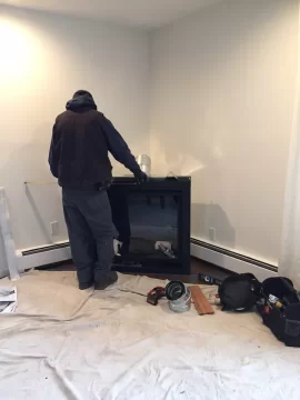

Ultimately we decided rather than dealing with coordinating between the dealer's crews and our plumber, electrician, etc we chose to use a local contractor several of our friends and neighbors had used for renovations and improvements. We met a couple of times, did some measurements, discussed style, and gave him the specs on the fireplace we wanted, He was able to secure the fireplace from one of the showroom dealers we had visited at the same price we were quoted and we had one point of contact for the whole process.
A good dealer or contractor will work with you to determine what 'style' you are looking to achieve with your new fireplace. In our case we looked at a lot of corner fireplace installations on the internet, pinterest, and dealer's websites that were just awful. Most looked like someone built a fireplace and 'shoved it into a corner'. We think ours looks like it has been 'here all along' as the design and proportions are right for the space. But keep searching and you'll find plenty of ideas to make your fireplace a focal point.

Did it work out cheaper using a contractor? What kind of contractor would I search for that does fireplace installs including the finish work?
Overall it probably worked out about the same but I had some additional work done; baseboard heat removed and replaced elsewhere, finished painting done, video cables run and TV mounted that wouldn't have been handled by the fireplace dealer. I think any general contractor that does additions, kitchen or bath remodeling, etc, would be able to help you. if you have a friends or relatives that have had work done recently that they are happy with that would be a place to start. Keep an eye out for contractors on the job around the neighborhood and inquire.
Funny you should ask about the mantel, it was custom built by our contractor. We weren't sure what we wanted and were all over the place on mantel design but I happened to do an internet search for "Benjamin Moore White Dove" which is the color of our walls and found an image with a mantel design that we really loved. Our contractor was able to build us one very similar on site. I have to say too the prices we were quoted from fireplace dealers for mantels and over mantels seemed ridiculously high.
