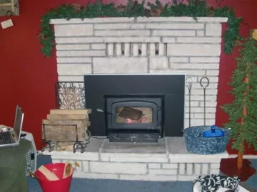

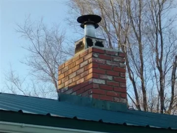

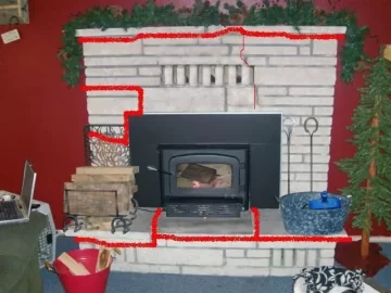

We have a Drolet Escape 1400 insert in a brick hearth with a metal Heatilator fireplace. A couple problems: the orginal owners of the house couldn't afford to do the job correctly, so they had Billy-Bob the cheap contractor do what he could....and it shows! The two bricks on top are loose, there is lots of mortar missing, and a large chunk on the left side is loose. There is also getting to be a decent size gap between the brick and the wall. His work also looks sloppy all the way up. The chimney on the roof is mainly held together with patch compound. Fortunately I had the sense to line it all the way up with 6" flex. We cut out the damper and part of the metal on the angled back of the fireplace to make room for the insert, shoved 'er in and it has worked great for a few years, but the whole wad is in rough shape.

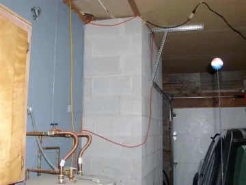

I'm hoping you all will get an idea of what I'm up against by seeing the picture and have some feedback on which way to tackle this. We would like to either keep the insert or if it's feasible, have a free-standing stove in the hole after we remodel. My wife and I are pretty handy around the house, and have plenty of able-bodied help. In the picture of the outer brick in the garage, notice the spliced/wire-nutted extension cord, and you'll get an idea of the capabilities of the previous owners...
