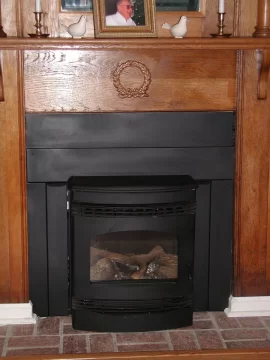

I was similarly stressed about trying to fit my Sante Fe in my little fireplace. The installer had a piece of heavy gauge steel cut to fit around the stove and inside wood. He then bent a smaller piece of thinner gauge metal above the stove to serve as a service opening. Also, he bent two vertical pieces to match the removable access doors that came with the stove. Have a look at what I ended up with. Hopefully, it's clear enough. Basically, you just make your own surround. No big deal.

My point was that you should not restrict yourself to a stove simply because the SURROUND doesn't fit your needs. If the stove fits, you like it, and it will fulfill your heating needs, then get it and make a surround that fits. The stove is doing the work, not the surround! It's just there to cover up the hole. You could even make it out of cement board and tile it! Ohhhhhhh,,,,,, hmmmmmmm.
