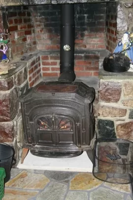

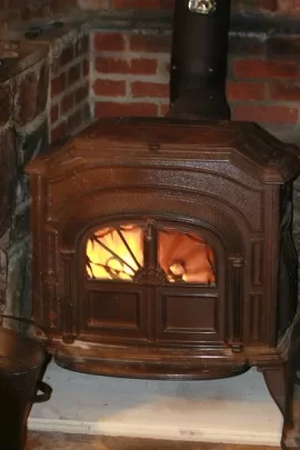

Have you checked out the stove? If not have a professional check it out totally. I have the same stove but of the 1985 vintage and it seems like a great stove. Placing near a gas pipe? NOT a good idea. I needs to have air all around it for it to work corrrectly since it is a radiating heat and so you want the heat radiating from front and back and sides and top, a lesson I have learned the hard way, mine was installed inside the hearth walls so radiates heat but I only get the effect from top and front as evidenced by below picture.
