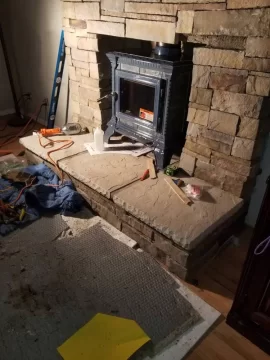

In am installing a Hearthstone tribute in a masonry fireplace I rebuilt. The clearances for a masonry fireplace (with the stove face protruding no more that 2" from the opening) are 18" for the mantle.
What I am confused about is that there appears to be a 9" clearance required between the stove and the top of the fireplace. Is this for combustables or the masonry itself? What is that 9 for in the manual?
Attached is a picture of my setup(mantle not attached yet) and the owner's manual.
