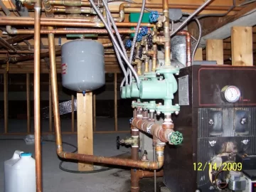

I forgot I had pictures on my work computer and found this one showing the circulator bank...I'm wondering if the flow control at the top of the picture may be sticking in the closed position, which would intermittently stop the flow???

maple1 said:
Not sure what kind of circs you have or other related details - but what stops the zone(s) from circulating by convection when it is not calling for heat?
See my picture. I'll check when I get home.

In the top of the pic it looks like he has taco sweat checks.
