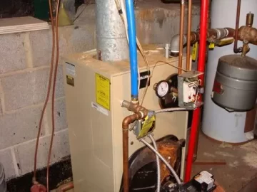

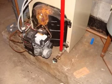

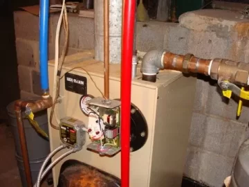

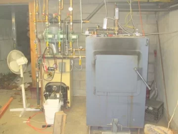

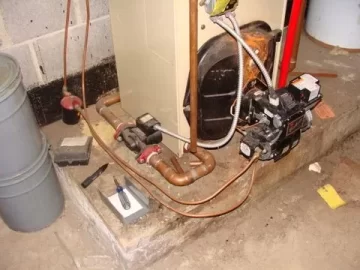

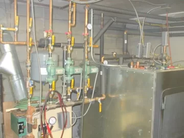

Im a newb and had a question concerning how my wood boiler just got hooked up to my existing oil boiler. He connected the incoming hot to the bottom drain of the oil boiler and the return water where the relief is on top of the oil boiler. The diagram for central has the hot going in the top of the existing boiler. Is this ok?
