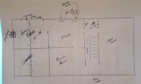

Thank you for your quick responses. I have attached a quick sketch of my downstairs ... very rough and not to scale, but I think will give a better idea of what I am dealing with. From your responses, I am still leaning towards an insert. But, now I am thinking wood may not be a good idea at all. I live on a one acre wooded lot, and I have two 80 foot red oaks that need to come down, plus other options. So, I was not overly concerned about a wood source. However, I have not cut and stored any wood of note. Until I got to this forum, I thought I could burn any wood ... pine, oak, maple, etc. I did know that "better" wood gets better results, but again, I thought I could burn anything. Maybe a wood insert is not a good idea? But if so, are the $1000-ish options still good (knowing I have more to spend on liner, etc.)?

Thanks for the sketch. You are right, it's going to be a bear to heat, but I do see the possibility of some sort of convection loop. Does the vaulted ceiling lead to an opening on the second level (ie open stairway) or is the ceiling just vaulted in the Kitchen?
Second, you can burn most any firewood as long as it's seasoned. Pine will give a much shorter burn time than oak, cherry, maple, or other hard woods, but it will throw heat, and many of us burn it here on the forums, myself included (similar climate to yours). Some will discount pine, but my vote is go for it, Out west, it's can be pretty much all they have.
I love my insert. It gives 7-9 hour burn times on primo firewood, and will throw heat (although minimal) for an hour or two after.It does have an extended front (protrudes from the FP, a huge plus in my book). I love my free stander, but wish it had a larger firebox. FYI the Englander insert has roughly the same size firebox as my free stander (Timber Ride is Englander). The max you're going to get for a burn time is 4-6 hours, depending upon what it's fed. Maybe an hour or 2 of residual heat after the fire burns down.
