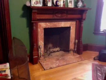

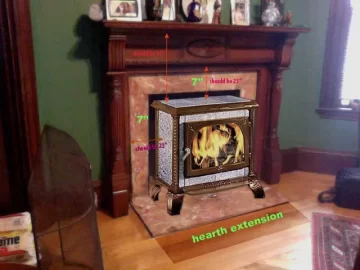

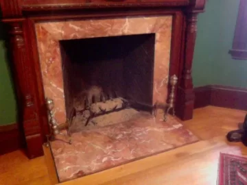

I posted a thread a month or so ago and got LOTS of help and great advice, however, I still haven't been able to find a stove/solution for my situation. I live in a home built in the late 1890s and I have a VERY small fireplace with a tight mantle. I would love to put a stove in front of it or partially in (or an insert), but I just can't find anything that meets my clearances. I'd rather not remove my mantle and do all the work involved in reconstructing a wall, but I'd be happy to extend my hearth (especially if I can do so easily). I'd love a stove with a 2.0 firebox with a nice big viewing window, but at this point, if I can get anything in there to at least create some warmth and glow, that would be great.
Here attached are my measurements, and a couple photos. I hope you all can help me
Fireplace Opening:
30" Height X 30" Width at opening
19-1/2" Width at back
14-3/4" Deep at top
Mantle:
From one side (inside) of the mantle to the other is 42 inches
From the bottom of the fireplace to the bottom of mantle is 35 inches.
Thanks!
Kenny
