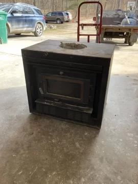

New member here.... needing help in finding a Zero clearance wood burning fireplace to replace 30 year old Appalachian Stove. Needs to fit into the original opening of 34"W. No room to enlarge opening, it looks like the house was built around this stove. My project is at a stand still until I find a replacement. Thanks

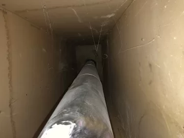

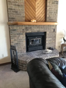

That could be challenging. Can you post some interior and exterior shots of the current setup and chimney so that we see what is currently installed?

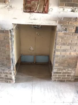

The wood framing you see is what’s holding up the brick chimney on the other side of the blue insulation. No room to make it wider, as far as i can tell.
spoke to them yesterday....they are having some EPA issues and probably won't have anything until Nov. this year. I can't wait that long. As you can see from the photos, I need to get my great room back together. I am considering building an entire new bigger fireplace.... but need to exhaust all my current options first.
The Gemini has a pretty dated look and that may not be what is desired for this upgrade. You are partway there already. Might as well go all the way and do it right.
