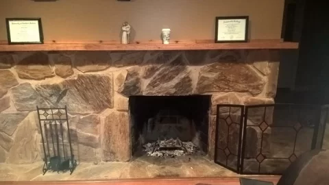

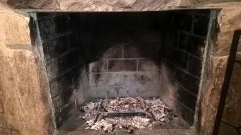

Hello,
I have been doing alot of reading and have ended up more confused than where i started. At this point i feel that a free standing stove would be best. One immediate question i have is that many stoves have a blower in the back. With this stove going into an existing masonry fireplace, wont this be an issue??
Pics to the fireplace are attached.
Here are the fireplace dimensions: Height: 32"; Depth - 18" in the fireplace itself, 35" to the wood floor. Length: 24" at the back of the fireplace, 36" at the entrance.
I am a buy once cry once type of guy. I am looking for a "no-frills option" and the "dream option" for comparison purposes. The house is 2700 sq ft, but all of it doesnt need to be heated. I also dont want to waste space with a small stove. It only needs to heat, no cooking needed.
Any suggestions would be helpful. Thank you!

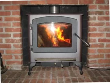

If I'm reading your post correctly you're looking for a freestander to put in the fireplace? If you are you need one that rear vents, if you look at my avatar I have the Woodstock progress hybrid set up like that but there's quite a few stoves to choose from.
Just checked on some measurements, looks like you can put any rear venter you want, all the Woodstock stoves. The Jotuls, there's more but I can't think of them right now, I'm sure you'll get more suggestions.
Got enough room that a freestanding Englander 30NC might fit in there for the no frills option. If it fits it would look a bit like BrotherBart's installation.
