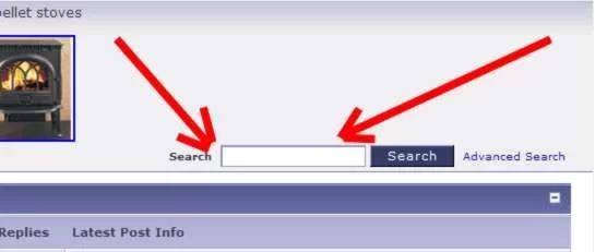

Gibbonboy said:Sorry for the sarcasm, alfski, and welcome. Get your notebook ready, these guys will fill you in with what's where, whether you want them to or not! I mainly deal with the results of improper installations and the efforts of those who don't seek advice before lighting off that stove.
