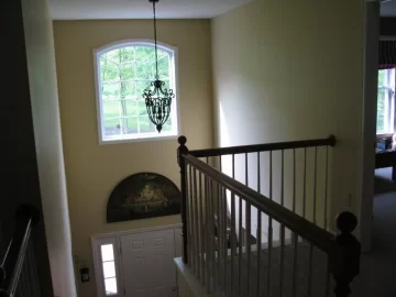

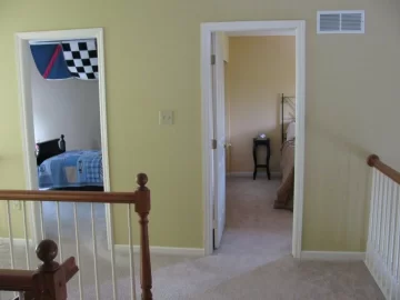

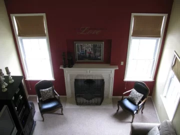

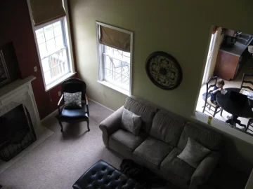

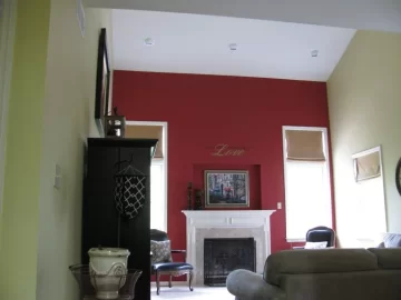

Hello All,
I'm new to pellet stoves. I've searched this board and I've read about 10-pages of threads in this forum and can't seem to find an answer to my questions. So, here it goes . . .
I'm very close to pulling the trigger on a Quadra-Fire MT Vernon AE Insert. It would replace my Mickey-Mouse propane "fireplace" in my 2-story family room. My home is a 2,800 sq. ft. colonial that's 7-1/2 years old. We use our 500-gallon propane tank to heat the house, the water, and to cook with. In the last 12-months I've spent $2,700 on propane and it doesn't look like it's going down any time soon.
I've researched wood pellet stoves enough to think they're really awesome and quite economical. However, I have (2) major concerns that I need help with:
1) Will all/most of the precious hot air simply rise upstairs where the 4-bedrooms are and not keep thing toasty on the first floor? During the day we spend most of our time in the kitchen and family room.
2) How do I "integrate" the new stove with my existing propane furnace? I want them to complement each other, not fight. I'm looking for a sizable reduction in my annual propane bill.
Note: I've heard about running my furnace’s blower to move the warm area throughout the house. Also, I've been told a fan placed upstairs, overlooking the family room, would solve the problem.
Bottom line: i don't want to spend thousands of dollars and only get a pretty fireplace.
Your advice is very much appreciated. Thank You!
You have a pretty good grip on things as you have stated.
Furnace fan running and add a ceiling fan at upper level are big pluses and will go a long way to even out the room temp.
Thermostat placement and set-back times will determine how the furnace and stove interact together and what temps other rooms will be at given times.
You need to look at it as heating different zones.
That is exactly what heated air does it rises until it hits something then it will follow what it has hit all the while cooling as the heat exits through the surface area the heated air flows over, when it gets cool enough it will start sinking to the floor to be reheated.
This creates two problems for you:
a. The real heat is at the wrong level for you to really enjoy.
b. The much larger volume of air in the room takes it a lot longer to heat. A large room with tall ceilings requires a lot of air to be moved, most convection blowers on pellet stoves are not really that good at moving large volumes of air. So it takes time and if the rooms surfaces dissipate the heat faster than the stove can produce it it will not get heated to your liking.
The furnace blower may be able to move the air but the stove may not be able to produce enough of it to completely take over the heating chores.
If your goal is reduce your propane use this is one way to integrate the stove into your setup. Set your stove up as manually fired and your furnace to CAC mode, and the furnace stat to where you like it to be for comfort.
You will have to base the firing rate on what the stove can continuously maintain and keep it full of pellets.
