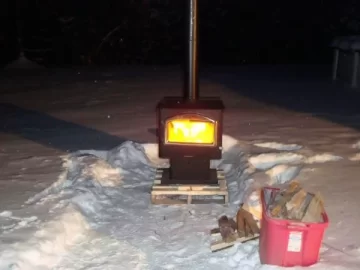

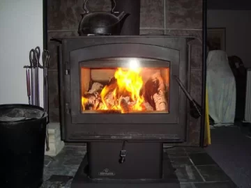

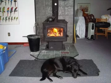

We got the new Napoleon 1450 installed today and what a difference from the old NC16.
I did 3 full burns outside yesterday and this morning which got rid of a lot of the smell, but there's still quite a bit coming off it - which worries me a bit as we have large parrots upstairs, but so far so good with fans going and windows open. (We learned the hard way that expanding foam insulation off-gasses cyanide...)
Wow - what a difference. I love the large firebox - 4 good sized splits in there NS and room for 4 more.
Burns nice and hot - I'm sitting in front of it with a patio door behind me wide open in -12C weather and I'm toasty warm. Took a little while to get the flue temp up to about 800 (probe at 18" up) , then backed it down to running around 500-600 flue temp. Guess I'll have to get a stove top thermometer soon. Will probably drop it down to run around 400 for a while, just wanted to run it hot for a while to burn off any more residue. Blower is pretty quiet too.

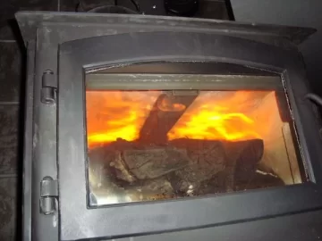

Love the secondary burn - how cool is that! If I could paint flames like that on my Mustang it would be awesome
Here some pics of the new stove and the outside burn plus the flames from the secondaries. Even the pup likes it already!

Very nice stove. May you and your enjoy it in good health. Nice dog, looks like he is enjoying the warmth.
Looks great and the dog seems to appreciate the new stove too. Did the outside burn melt away all that snow? :)

Nope, wish it had... Won't be seeing grass again until April.
