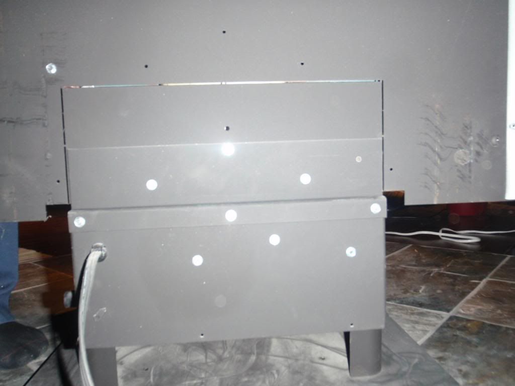

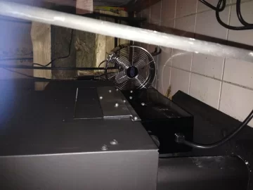

Does anyone have a picture of the correct placement of the bracket and blower for the 1450 or similar? I have searched the web and I only found a not so helpful manual picture. Thanks in advance.
Well here is the back shot of my assumed installation, you'd think these companies would provide a better manual or installation picture.
The picture is sideways, sorry. Does this look right?

Thanks blueguy, I see my bracket is backwards. Thanks again. Good thing I switched it, the motor was touching the secondary channel and may have burned up prematurely.
