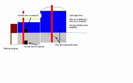

O.K. gang I know this forum is full of heating from the basement questions. But I didn’t find a scenario like mine to compare with. I have attached a sketch of my layout and I hope it is legible. I have a 1200ft2 home that is 100+ years old with a walk out basement. Poor to zero insulation in some areas. The basement has a very nice propane heater in the walk out section It heats the basement well enough to keep pipes from getting too cold. I also have a propane vent less fireplace in the first floor dining room. My question is should I heat from the basement or should I heat from the first floor kitchen. I just purchased a Napoleon 1400PL stove that pumps 70,000 BTU per hour. Is this thing going to blow me out of the kitchen? In the sketch I try to display that the stove would be located quite a ways from the basement stair well. Also, the walkout basement section is made of Stone and brick with two wood windows down there. Anyway, let me know what you think.

Well, I'm not sure what the vertical red lines are - maybe chimneys? But, you mention that the unit in the dining room is ventless propane. There is no doubt that you will probably get better heat in your living space from a unit on the first floor. I assume that the red vertical mark to the left is a masonry chimney (or is it just a potential spot for a pipe chimney?). If you are putting in a new chimney (piping) I would place it at your dining room area to get better flow upstairs to your other area, but I would need to see your stairs location and understand the doorways/openings between rooms on your first floor. Getting wood to the unit might be easier from the basement to a basement stove, but unless it is well insulated down there the walls might suck up most of the heat and you would have very little left over to travel upstairs.

And yes those big red lines are current chimney locations. The one on the right is used for the oil furnace thats why the to proposed stove locations are on the left side of the picture. If you click on the image you can see the stair well locations better.
Do you think 70,000 BTU per hour is too much for 1,200 Square feet?
I would definitely put it in location 1, again, to get the most heat out of it into your living area. Is that a deck off the back of the house? Is there access to the kitchen directly or through a family room, etc., for bringing in your wood?
On the stove I think that the unit might do fine by you. You say the house is poorly insulated so it's impossible to tell whether it will be adequate to heat the house and without knowing what you expect in heat output no one can really say. It's a medium stove rated for up to 2,000 sq. feet, but the ratings don't tell you much. With your location and level of insulation in your house I would not have gone any smaller, that's for sure. I have a Lopi in my basement (approx. 1300 sq. ft.) that is a similar size and rating and with my uninsulated walls I can raise the temperature from 51F to 62F in about 10 hours, but it needs to be constantly maintained to hold back the cold from the floor and walls. (One of my summer/fall projects is to insulate and condition that space much better which I hope will make a big difference.)

Actually that is a porch / entry mud room off the back of the house. It used to have old wood windows and I replaced them with new Paradigm vinyl windows this fall. That porch will be fully insulated and sheet rocked by Winter. So that allows me to bring wood in right from that porch. I was a little startlled to read that is takes 10 hours to gain 10 degrees in the basement. Is that at a slow burn? or is the stove bent right over to get that degree change?
