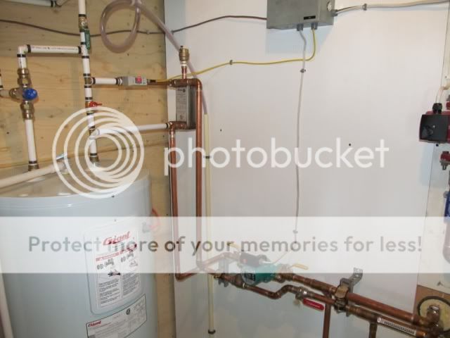

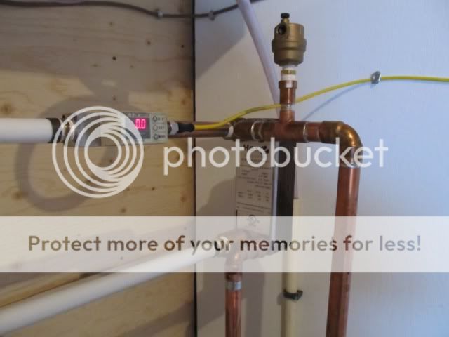

This week I hooked the plate exchanger for my domestic hot water. I install a flow switch in the cold water line so if it see some flow it's turn on the pump who supply the hot glycol. I have good result with that system.
[Hearth.com] My two little brown baby + DHW update.
I purchase that flow switch on ebay for 9$
It all looks good, did mine a little different, ran my tank as a zone with a plate. Lab looks cute, I got a min pin, you talk about a bark. Got mine done and been running now a week, the basement has been calling, and hot water. We haven't used the 10 bags of pellets we purchased, pretty impressed. I will post my pictures.

Cute flow switch, is it a SMC brand? Will it trigger with a small .5 gpm flow, like a sink faucet?
