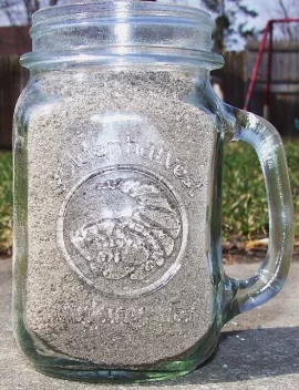

SUMMERSET- Date on bag: 03/15/10
Avg stove temp-173
avg exhaust temp-250
approximately 10 oz of ash
outside conditions
avg temp: 53
avg humidity 58%
avg Kpa 101

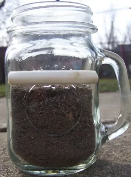

STOVE CHOW- Date on bag: 2/15/11
Avg stove temp- 160
Avg exhaust temp- 250
approximately -15 oz of ash

Outside conditions
Avg temp 33
Avg humidity-69%
Avg Kpa-103

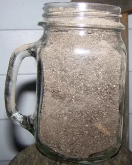

---------------------------------------------------------------------------------------------------------------- FIRESIDE ULTRA- Date on bag: 01/07/11
Avg stove temp- 165
Avg exhaust temp- 230
approximately-20 oz of ash
Outside conditions
Avg temp- 34
Avg humidity- 56%
Avg Kpa- 103
