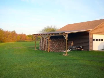

I got sick of covering my wood with tarps so built a 12x24 shed off the side of my garage at the end of this summer. It has been nice to go out the past few rainy days and see my wood still sitting high and dry. I am also replacing our old Dutchwest Fedaral Airtight stove with a new Jotul Oslo so I am excited and ready for winter.

With the way the wind blows at my house I usually never have to worry about a snow load:) Before winter comes I hope to enclose the two ends of the shed.
Nice work Haybale. I might caution you on enclosing both ends though. As it is, wind can not get through the stack so it will no doubt take longer to season, unless you season it before storing in the shed. If not, then I'd for sure not enclose the ends tight. Leave air spaces between the boards so it can breath.

Well I guess I get to be the one to piss on the parade.
Haybale,
While you obviously made a pretty admirable effort, I see a few things there in the details of the construction of the shed that should cause you real concern.
First would be the overall size & pitch of the roof in conjunction with the size, span and bearing of the support beam and rafters. Think heavy snow & ice loads...
Second and most significant and the problem you are most likely to actually encounter is wind uplift. The way the shed roof sits on top of the garage roof is wrong for several reasons but mostly because wind uplift in a storm is likely to tear it right off as it is configured. You should have bolted a ledger to the side wall just under the garage roof, bolted into the garage's wall studs. In this same regard, are the outer posts holding the beam secured into the ground in any way? Also, you should have hurricane straps or other metal plates holding the rafters to that beam.
Lastly, think about the path of water coming down your garage roof and hitting the shed roof.
Don't mean to be a critic man but I've spent my life building and inspecting houses and though it may not happen for a while, you've got a recipe for a real problem there.
