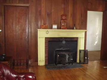

BEFORE: The picture with the paneling and the ol'slammer Timberline was what the house & fireplace looked like when we bought the place back in July.

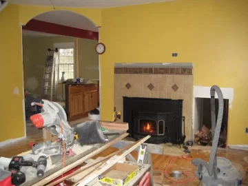

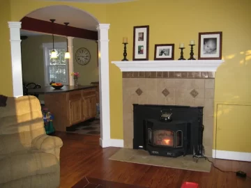

DURING & AFTER: We have spent every night and weekend for six months to update the house into this with an open floor plan. For the fireplace, I had to extend the hearth and the surround and tile it. Installed a full SS flex liner. Installed a block off plate and insulated with Rock wool. I also put in a wood bin next to to the fireplace.
The WOOD BIN ... half of my pride and joy with this project. Since it is so hard to see in the AFTER picture, I will give you a hint ... it is to the right.
In addition to the door you see is a door on the opposite end and I made a cart that is the full size of the bin. The opposite end is near the back door for easy and clean(er) bringing wood in. So I bring in wood every 2-3 days now ... to do so I roll the cart out on the opposite side by the back door and I bring in all my wood and stack it in the cart. Do a quick sweep up by the back door and roll the full cart into the bin and close the doors ... all the mess is out of sight
To load the fireplace just open the door and grab your pieces ... if need be roll the cart out for access to more wood. I love the system ... it works great!
The only thing I have left to do is rewire the fan on the insert. I plan on running the wire to an outlet in the basement where I can set up a battery back-up/generator system for the event of a power outage.
