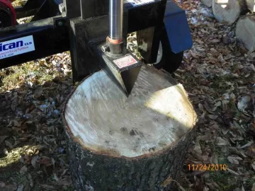

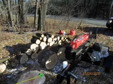

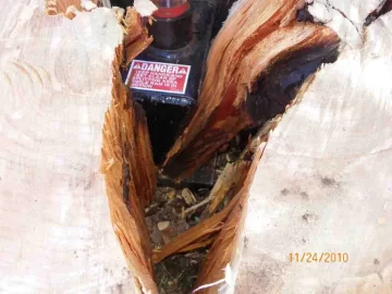

Things had been going real good today until I went to use the splitter (just used it two days ago and it was fine) I pulled way to many times (no spark) and flooded it so I gave a call to the wife and zoom a new spark plug and we were up and running but by then I was one hour behind, the lesson I learned is I shall change the spark plug yearly.

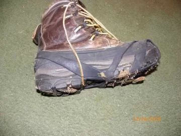

We had a dusting of snow so I threw on the spikes they use for ice fishing.

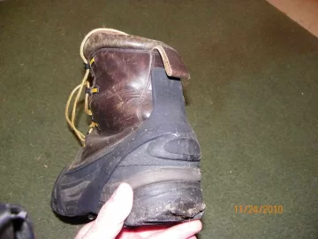

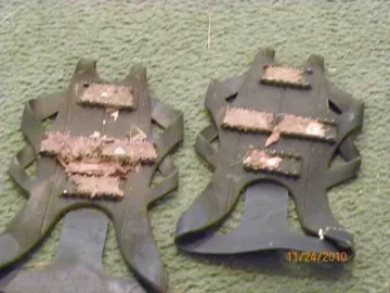

Ok, I'm willing to show my ignorance here............what are the pair of tools in the bottom photo?
-Soupy1957
-Soupy1957
Soupy1957 they are pullover your boots spikes they use when walking on ice, I use them when I cut in the winter and when the frost is in the ground. You put them over your toes on your boot then pull them up over your heel.

Zap- what size is that splitter of yours?
24 ton American CLS, other than today it starts on the second pull in the dead of winter.

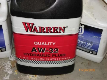

With hydro fluid, or ATF in it?
I fussed about that on mine but after reading as much as I could I went with ATF for the low temps, ATF is a much better hydraulic fluid than I realized, the place I bought the splitter did not even know that.

What is the difference between hydro fluid and ATF for your splitter. After finishing the stacking from the wood I split today we decided to push in some wood before the rain and sleet hits so I had to use the splitter I put the plug in yesterday and it took off on the second pull.
zap
Zap- The manual for my Huskee 22 ton states that when splitting in temps of 32 °F or below , to use ATF. It does not state why, but I'm sure it has to do with viscosity charecteristics when the fluids freeze and thicken up. I'd suppose it would (could, I should say) stress the pump a bit more with thick,frozen hydro fluid and could possibly shorten the life of the pump. Just my WAG.
