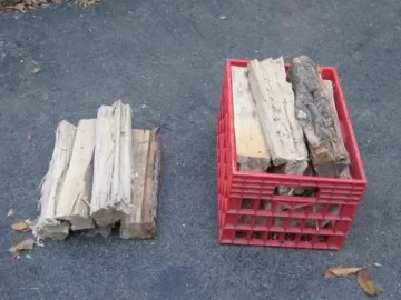

I brought 16†splits of cottonwood (nice and light) to see how much more wood the new stove can fit relative to my FV. The milk crate full of wood in the picture is exactly what fit in a Fireview, right up to the top. The rest of the wood is the difference you can fit into the Progress. It was a little tricky, since the progress technically takes up to 22†splits. The new stove could actually fit a couple of 16†splits vertically (that’s right, standing up in the firebox!) The tallest point was 16.5†in the front and sloped lower towards the rear. The E/W direction was 23†max just above the bottom of the door. The N/S direction was 15†max. I was told you can stack right up to (but not touching) the stainless steel baffle plate. You just need for the holes to be able to “breath†for the secondaries to work.
I was a little surprised the firebox did not fit even more, but I suspect using full 22†splits would have better utilized the extra space.

You are right that the longer lengths of firewood would make a big difference. Consider that is you us 22" splits instead of 16", that is a 35% or so increase in firewood volume. Add to that the extra splits, and you probably have 60-70% more pounds of firewood capacity. That can make a big difference.
