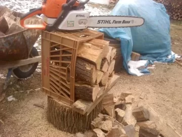

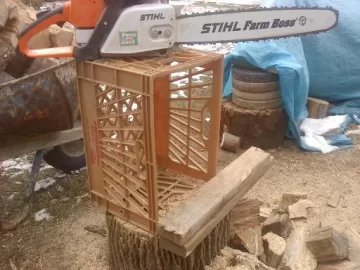

I bought a new stove this year,and started burning N/S. I had to shorten lots of my supply, so I used an idea I found on here ( I think it was Zaps box ). Most of us have a milk crate lying around somewhere, and we ALL have a round to screw it to!! A couple of drywall screws hold the crate to the round, and I screwed a few pieces of 2x4 in front just to keep the splits from sliding out (it tilts them back,slightly). I pack that box as tight as I can, and the 20" bar on the 290 does the rest. It works for me. Hope this helps someone. Burn on, brothers. (and sisters) ![Smile :) :)](/talk/styles/default/xenforo/smileys/grin.gif)
