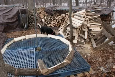

I finished my HH yesterday and took some pictures of the project along the way. This one has a 7' diameter, 5' tall to the "roof" and 8' tall at the top. By m math has 1.8 cords in it (pi * r2 * h) for the cylinder + ((pi * r2 * h)/3) for the cone shaped roof)
A couple things I learned along the way:
* be sure to maintain the angle down and in on the outside ring
* fill the center as you go
* I didnt get any more wood in the foot print than I did with a "square" pile in same spot
* if I do another I will do the roof a little different having less pitch and higher rows overlapping
I did mark the center pole to see how much it shrinks over time.
All in all, a fun project.

Wow, nice job....I like the pitched roof as well, most are often a little more flat.
Very nice. I wish I had the time/patience to build one. What is the purpose or the strategy of the outside horizontly laid pieces (they lay perpendicular with most of the other wood)?

From a time perspective, it really didnt take much longer than a normal stack would have. Filling the center by "chucking in" the splits contributes to the speed. Having done it once, the next time would be quicker too.
The outside horizontal pieces are used to create the "down and in" angle. If you look at the wall you will see other horizontal pieces put in the re-establish the pitch. This is needed to provide stability to the wall.

Looks good man! Double pallets to get it further up off the ground? It looks great with your other stacks, you've got a "wood village" back there now....
You noticed the "double pallets" .... actually the reason why is the bottom pallets were frozen solid to the ground and I couldnt budge them w/o breaking them up. I had scored those plastic pallets that I wanted to use so I just put them on top and leveled it off. Can only help air flow.

'Down and in angle' ... seems like that would funnel any rain hitting the outside wall right to the interior of the stack? Seems like 'in and up' would help shed more water?

I could reach the top using a milk crate to step on. For the Very top I did use a step ladder to make it easier.
Yes, the middle is full - I just chucked in splits to fill it

Got Wood, I am glad you got a chance to build one, I know you liked mine. You are right the key to strength is to keep the wood leaning in, really not hard to do. I agree that the roof looks a little steep, but nice job. I found I could reach the top by finding foot holds in the side and stepping up. Now you will get all your friends and visitors talking. Everyone has seen a wood stack, but not too many have ever seen a HH.
