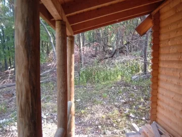

Actually, they don't match up because it's a log cabin. They have to be offset at the corners (see photo of exterior).
