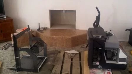

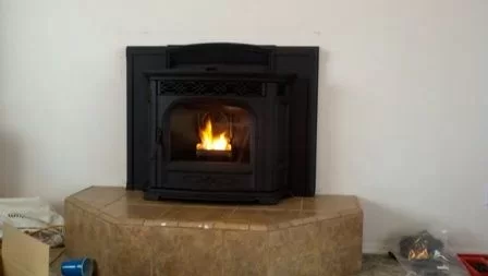

Well I got my Accentra Insert in days before the big cold snap in November. I made a custom OAK that works like a champ. I must say we are impressed with the heat output and overall appearance of the stove. To Harmans credit the install was fairly basic even with my two left hands. In the end my wife and I slid the insert in to the surround, that was a site to see, but we took our time and used 2x4's to set the stove on in order to protect the bottom fan. Stove has been running for a month and I have nothing but good things to say about it. I did my first big clean out yesterday and can see why you need to stay on top of the cleaning. Found alot of fine ash back in the heat caverns that run to the rear of the stove. Thanks to all who helped me with my stove choice, hope i can pass on some of my install experience to any who need it. Heres some pics for you pic hungry folks.
