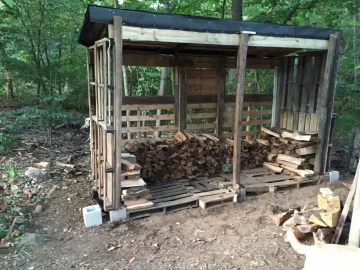

This year has been amazing for free wood. People just keep giving me more, and I keep taking. Decided I needed more room to store the stuff so I started to build a new woodshed.
Since I am cheap, I tried to make this as low cost as possible.
I used a bunch of pallets from work, some landscape timbers reclaimed from a neighbor, 2x8s from having my old deck torn down, and roofing materials left over from when Sandy destroyed my boss's roof.
Overall finished cost was $30. I had to buy hurricane straps, a few lag bolts, and 2 pieces of plywood only. Everything else was just lying around.
First I started off placing the posts and the pallets together. The back was made of a huge 12 foot pallet that lumber for the deck was delivered on.
Here you can see all the wood piling up, and comparison to the old shed.
I used a 1x12 as my measuring stick and to level the ground.
Foreman Lila inspected all aspects of my work as I put the roof up.

View of the back. Added a cut in half pallet for more roof support.
![My $30 Woodshed My $30 Woodshed](https://www.hearth.com/talk/data/attachments/161/161413-cbde76135bca13bfd0aa9c65767c439b.jpg)
![My $30 Woodshed My $30 Woodshed](https://www.hearth.com/talk/data/attachments/161/161414-95d846dd2a3d9b1c3e044a070fa8f207.jpg)
![My $30 Woodshed My $30 Woodshed](https://www.hearth.com/talk/data/attachments/161/161415-41da99b8264516fc5daa7c38a14e547f.jpg)
