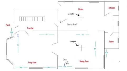

Here is my layout been trying different things each night with the fans etc, dont think i have it yet :)
thats the first floor, 3 bedrooms up stairs

Kast..... Your layout is nearly identical to mine with one small variation which is an interior window between what would be your pantry and dining room. In this window I have a simple 3 speed box fan. My stove sits in the corner to the right of your stove location....... Here is what I have been able to do so far.... Dining room temp 76.... all other downstairs rooms 71. Upstairs about 62 in all rooms but was able to get around 65 using fans in the stair area. The gain in temp was not worth the hastle so I got an electric blanket. Other info..... house is around 2100 sq ft..... Outside temp 30*........ House is about 135 yrs old......

BadDad320 My house is about 1100SF and almost the same temps you get, still working on the right fan placement, with out having to many fans and using a lot of electricity.
pt0872 how did you place the fan, towards the stove in the same room or just in the cold room blowing towards the room with the stove?
