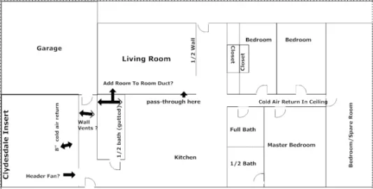

just checking to see if there has been anyone with updated luck moving heat in a ranch
yes, I understand the concept of pointing the cold at the heat..
as an update to the pic, we have done the pass through, also now have a header fan between the insert room (this has helped alot...but there is still a boatload of heat in the stove room..Such a waste....Considering a ceiling fan too (would like a nice one in black)..
main ? is :would like to do a insulated flex duct/wall pass through from stove room to living room or go through attic?
anyone actually have any luck with this?
already have a return in stove room...but it did didly
