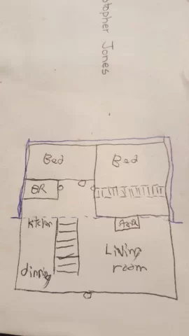

Here is a rough floor plan. The blue pen indicates where my master bedroom is upstairs. I only drew the floor i was trying to heat. There is a fan box already mounted in the living room. Its directly centered in the living room between the blue hashed line and on the ridge board. [Hearth.com] Moving heat around with fans [Hearth.com] Moving heat around with fans

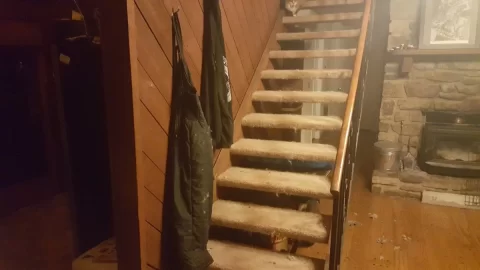

And there is the perspective from the front door

Is there a vaulted ceiling in the stove room, or just a smallish opening at the top of the stairs to your bedroom? Tell us where the heat is going now, vs. where you need the heat to go. Is too much warm air going upstairs? Are there kids that hang out in the other BRs on the main floor, and they need heat?

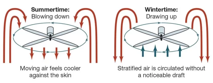

I was always told that upwards was the winter setting and downwards was the summer setting, which is a bit counter-intuitive and I observe that lots of people do it the other way around. I'm still not sure which is most effective.

Vaulted all the way up, probably 20'. Actually right now its just me in the house upstairs, had a renter in one of the bedrooms but he's moved out. so I've been keeping the door to the basement and both bedrooms closed to keep the heat to myself! In the process of selecting another renter but don't want to literally invite trouble into my house. The spare rooms are easily 10 degrees different with the insert going and was curious about how I could keep it warm back there and upstairs in my room. The other thing I should mention is I have my HVAC fan circulate air for 15 mins every hour to try to even it out. good/bad/depends on return?
I don't use them much in the winter, and have them blowing up in summer. If it's on, it's because I want to feel some air circulating, and I don't normally sit in the middle of a room.
definitely clockwise in the winter....
when you are standing under a fan moving counterclockwise, you can feel the draft. Very rarely you will feel the warm air blowing down on you. We notice a 4-5º difference when the fireplace is going and the fan is moving slowly in reverse.
