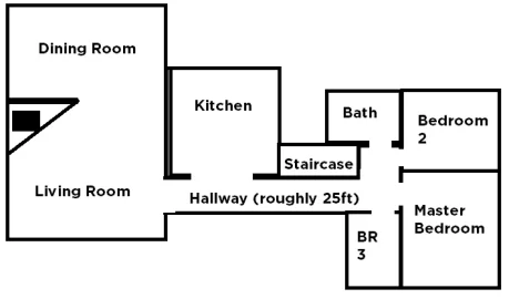

This question has come up a million times, but i'm looking to pick everyones brains as to what YOU would do that is not only functional, but also realistic.
We have a wide ranch style home with a second floor. Long narrow hallway separates the living area of the house from the sleeping area of the house. The woodstove is in the living room against a false wall between the LR and DR.
During the winter, the wood stove gets plenty hot, and can easily raise the temperature in the DR and LR without pushing it, however the other side of the house where the bedrooms are, sees none of this heat. The house is decently insulated, with a few drafts that i've been closing up year over year, so i'm fairly confident at this point theres no major drafts causing heat loss. The thermostat is located on the wall in the beginning of the hallway closer to the living room, so when the stove is running, the thermostat shuts off heat to the bedrooms since its seeing temps much higher than we typically have the thermostat set to, even though the bedrooms are now freezing.
I tried putting a vornado fan on the floor outside bedroom3/master bedroom to blow cold air on the floor towards the living room, but it really doesnt seem to make more than a couple degree difference. Above the hallway and bedrooms i have a crawlspace in the second floor and i was considering putting a bathroom vent in the ceiling of the LR, and running ductwork down the crawlspace and exiting in the ceiling at the end of the hallway to aid in drawing some warm air, but i nkow moving hot air is more difficult than cold, however i cant run any ductwork underneath the floor.
Any thoughts as to something that would help in my situation? I really want to avoid having all kinds of fans just sitting on the floor in the hallway, as even the one Vornado fan was always a tripping hazard in the middle of the night. I thought about putting wireless thermostat sensors in the bedrooms, and using those to control the radiator heat to compensate, but seems like that would be counterintuitive to using a wood stove to save on heating costs
