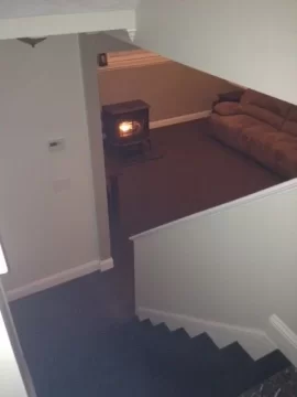

you make some interesting points Dexter my bedroom upstairs above the garage is cold its big about 30x30 my thermostat ( for the regular furnace ) for upstairs is in the hallway just before entering my bedroom and i get in within a couple degrees to downstairs so i am happy about that so the heat is reaching there just not enough to warm it or go thru the doorway i was going to put a fan at the top of the stairs blowing the warm air in,to blow down the hall into my bedroom but if i read correctly i should be blowing the cold air out ?
another theory im debating i have a ceiling fan in there i was thinking if i set the fan to draw upwards i would be trying to pull the warm air into the room now im thinking maybe i should reverse it and push it in the down direction. your thoughts ?
btw im running on low setting and letting it run all it wants if i need a little more ill bump it up accordingly for a bit
i am pretty impressed what these pellet stoves are capable of so far
one more thought, what about closing the returns on the duct work so the heat dont escape thru it ? do people do that ?
