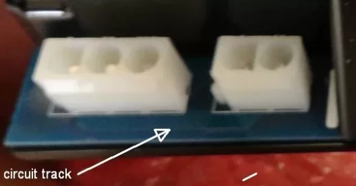

The only other thing that I can suggest is checking the Voltages at the input and output of the power supply. If you have a Voltmeter and are very careful you should be able to do that safely. I can't get into my MV right now, but I expect that the three pin connector has AC power (line and neutral) and "ground" on it. The two pin connector next to the three pin appears to have a track going to the three pin and may be a path to the igniter.

The more remote connector should be the DC output.
You need to determine if the supply has AC input and DC output. If the AC is there but not the DC it almost has to be the supply at fault. If the AC is missing dig deeper into the wiring. There may very well be another fuse.
