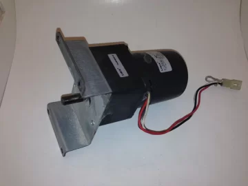

According to the Enviro Web Site the OEM Igniter for the Meridian and all VF models is 300 watt.
The 1/2" diameter probably includes the housing. I believe the heater element is the standard 3/8" diameter inside.

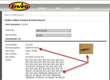

No, Don is correct. We're talking about the VistaFlame VF100 ignitor which is part number 50-1067 and 300W. That's what the manual says. The link you posted for the 400W even states it's not for this stove.
